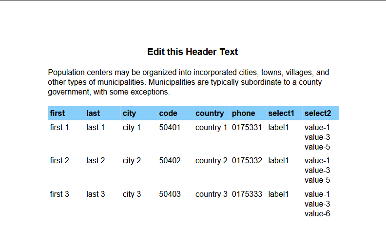

Hier ein Beispiel für eine Tabelle ohne jeglichen Rahmen.
Achte auf folgendes HTML-Attribut im table-Element: border="0".
PDF-Dokument:
vi-solutions.de/forum-uploads/pdf-templa...-without-borders.png
Der HTML-Teil der Tabelle:
<table width="100%" cellpadding="4" border="0"> <tbody> <tr style="font-weight: bold; background-color: lightskyblue;"> <td colspan="1" align="left">${first|DISPLAYLABEL}</td> <td colspan="1" align="left">${last|DISPLAYLABEL}</td> <td colspan="1" align="left">${city|DISPLAYLABEL}</td> <td colspan="1" align="left">${code|DISPLAYLABEL}</td> <td colspan="1" align="left">${country|DISPLAYLABEL}</td> <td colspan="1" align="left">${phone|DISPLAYLABEL}</td> <td colspan="1" align="left">${select-1|DISPLAYLABEL}</td> <td colspan="1" align="left">${select-2|DISPLAYLABEL}</td> </tr> <tr class="loop"> <td colspan="1" align="left">${first}</td> <td colspan="1" align="left">${last}</td> <td colspan="1" align="left">${city}</td> <td colspan="1" align="left">${code}</td> <td colspan="1" align="left">${country}</td> <td colspan="1" align="left">${phone}</td> <td colspan="1" align="left">${select-1}</td> <td colspan="1" align="left">${item:select-2|DISPLAYOPTIONVALUEASLIST}</td> </tr> </tbody> </table>
