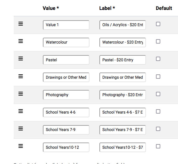

Hi- I'm having an issue where I have a set of Radio Buttons with various category options for a local art show.
When the user makes a selection, the value returned is the option Label, not the option Value. For example, selecting the first option in this list returns the value "Oils / Acrylics - $20 Entry", not "Value 1"

For example, in the backend, I'm setting the Option (that the User sees in the frontend) as "Oils / Acrylics - $20 Entry", with a Value (what I expect to get back in the Result email) of "Value 1". When the form is actually submitted, what I, and the User get in the Result email is:
Entry 1 Category : Oils /Acrylic - $20 Entry
What I'm expecting is
Entry 1 Category : Value 1
It is quite possible I've set this up incorrectly, but I can't see what I'm doing wrong. It seems to only return the Label for this field, instead of the Value that's been set.
*** Follow Up***
I have another field on the form with the Label "Entry Fee $20" and the Value "20.00". If the User selects this option, it too returns the result "Entry Fee $20", but the 20.00 value is used correctly in the calculation field. The instructions say "Value is the value, that is submitted with the form, if this option is selected. Label is the option label, which is visible to the user." It's possible I'm misinterpreting what this means.
*** Follow Up #2***
I've just had a look at the datasets. "Value" is recorded there correctly. I'm interpreting "submitted with the form" as meaning "sent back to the user" - that might not be what you intended.

Thanks Ingmar - that's a far more detailed explanation, and I am reading through the documentation on Placeholders in result emails, which looks extremely powerful.  In my case, it still looks as though the result is not what I would expect:
According to your reply, the Option Label is NOT transmitted in the form post request, but that's what I'm seeing.
For example the field set:
Label: "Entry 1 Category :"
Option:"Oils /Acrylic $20 Entry"
Value: "Oils /Acrylic"
gives the following in the result email (to User and Admin)
"Entry 1 Category : Oils /Acrylic $20 Entry"
In the database, it's stored as:
"Entry 1 Category : Oils /Acrylic"
This is not a big deal, and the form will work perfectly for us - I'm just puzzled about what I'm doing wrong.
