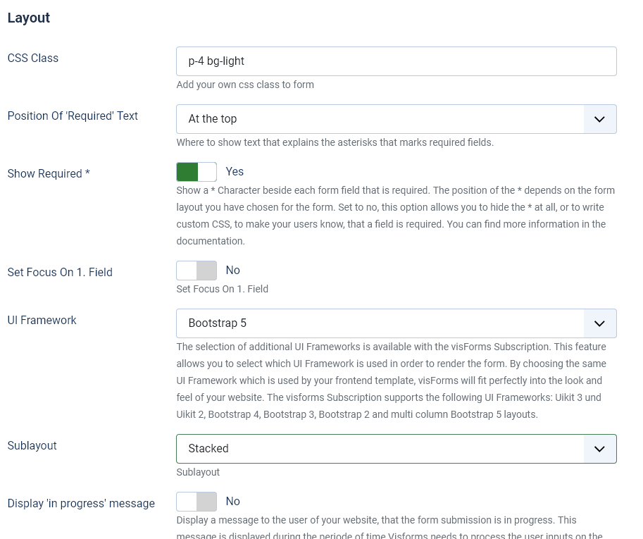

2 Jahre 10 Monate her #9015 von Administrator IV
Administrator IV antwortete auf Custom Text Position above input
Hello mojweb,
in order to help you, we need the following information:
- which UI framework your template uses,
- which UI framework is set in Visforms (form configuration, tab 'Advanced', group 'Layout'),
- which sub-layout is set in Visforms, if any (form configuration, tab 'Advanced', group 'Layout'),
- a link to the form or the screenshots (would be very helpful).

2 Jahre 10 Monate her #9022 von mojweb
mojweb antwortete auf Custom Text Position above input
Using Helix Ultimate - Bootstrap 5.2. Working on localhost. I gues the sublayout is the problem?
2 Jahre 10 Monate her #9024 von Administrator IV
Hi mojweb,
Thank you for the detailed information about your settings.
With this we can reproduce the error.
There is practically only the variant above the label and below the input field.
Other layouts with similar settings are also affected (Bootstrap 4, Bootstrap 5 and UIkit 2 and 3 layouts).
It has nothing to do with the sub-layout setting.
This area is complex and not easy to correct without unwanted side effects.
So I can't say at the moment whether there will be a quick, simple solution (workaround).
I created a development issue for the bug list:
Issue [VF-747] Forum: Bug fix: Selection 'Above input': custom text shows above label
When we release the bug fix, you will be explicitly informed about the release here in the topic.
